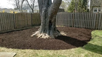

This may be a long shot but, regarding mulch- I recently listened to a presentation of findings in mulch research, I think from Michigan State. I recall that one type of mulch had no benefit to trees and the trees may have actually fared worse than the ones with no mulch. I believe it was referred to as Cedar mulch, is that what's in the picture?
Gosh could be. We generally use hardwood, pine bark occasionally, compost, or a mix of all 3 around here. Hardwood is far and away more common.
All OM over time will provide some benefit but its interesting that cedar would be worse than others. Perhaps due to it being conifer wood or bark? Idk.
Could an allelopathic response from cedar. Dont know. You can get that stuff at Lowes or Home Depot but not mulch producers or supplers here.

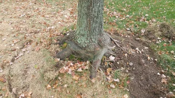

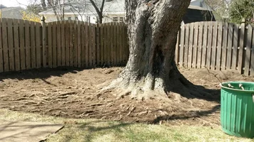

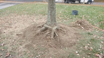

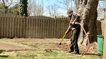

Just for something to gander at .. I've been cutting too many lately been missing a little spading .

20161109_122239.webp 20161109_154132.webp red maples. Fun.
I cant find most of the after pics showing the sgr removals, perhaps throwing my phone in disgust after two days of red maples like these had something to do with that though

Seriously I don't understand blowing >1' away from the trunk.
