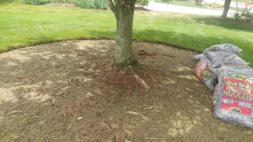

Doodie Head (A. rubrum)is actually in very good shape, I removed a SGR a few years back and included it because we're putting a big bed around it.
Poop and Caca (A. platanoides) were the time consuming buggers.
I string trim it until the white crown of the turf is visible and you can see the thatch/soil. Then we covered it with a thick mulch layer to smother it.
If some survives, and some always does, I can come back and zap it if need be. Vinegar or pelargonic acid work well on stressed turf survivors as does glyphosate but the formers are less risk.

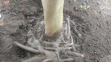

I've been reusing the removed feeder roots as you've show here since you mentioned the practice some time ago.

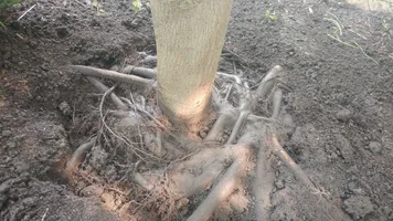

You laugh and curse those who keep very expensive Japanese maples in containers for way too long and dont root prune between "up-potting" stages during nursery production...
I brought out the home owner and showed him how bad it was. He said " What the hell, do it. If it lives great."
His other two weren't nearly as bad.
You pick an area to start at and work around from there to give your hands and tools room to work. Felco pruners, loppers, little Silky Excell, SHARP chisels, some with rounded ends are the best in many situations. Phase job over a few years

Rare and very expensive J maples. That one was declining a bit too.
We'll give it a whirl. Homeowner was very into the process of removal and how SGRs can occur. Good dude.

IMG_0400.webp IMG_0455.webp IMG_0457.webp IMG_0413.webp IMG_0416.webp IMG_0421.webp Initial visit was the brown tree on July 29.
Airspade and root pruning august 8/9
After photos 8/30
