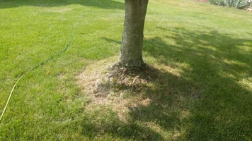

Thanks that was exactly the information I needed. They were definitely small as they were only 12 year old trees. Mostly preventative work.
Sent from my SM-G920W8 using Tapatalk
This is Poop.
This is Caca.
This is Doodie Head.
Everyone now tell Poop, Caca, and Doodie Head to go to Hell. Lots of sod to remove, adventitious, and girdling roots. Put some after pics up later.
