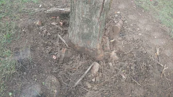

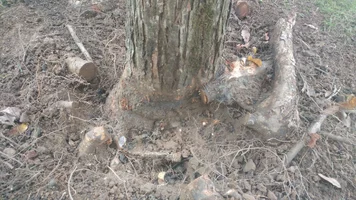

Root Collar Excavation
Cercidophyllum?
Here's a hybrid elm
View attachment 47241 View attachment 47242 View attachment 47243 View attachment 47243 View attachment 47244
Had a bad bark tear on one cut but it was pretty superficial
Holy crap.... yeah, it's a Katsura. Granted I made the tree owner water the crap out of it. We are in one of the driest years on record and in a rainshadow climate that has niche populations of prickly pear cacti. However I've never seen results like this before.
Looks like your bark tear is outside the removal cut, so unless it's grafted your golden. Have you ever come back on a tree like that a few years later to see the response growth? I am less than a year into root work, but I keep this in the back of my mind constantly when doing this work.
Absolutely you schedule a followup. Especially when significant root loss has occurred and a watering regime has to be followed to compensate.
In very bad cases the root pruning jas to be phased in over rhe years too
Gotcha. That does help, however I'm more so questioning epicormic response. Often we try our best but cannot make perfect cuts, and even when perfect cuts are made in the canopy there is a epicormic responce. Just wondering what the follow up looks like. Obviously I haven't been doing root work long enough to get an idea of a base line, to figure out targeted follow ups.
Shouldn't be much epicormic growth response if any. The primary concern is how well the tree is doing after root loss
