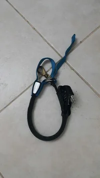

And someone else mentioned this earlier so I will throw it out... I use the haas in the tree all the time, even for relatively short ascents. Especially now with the clip in style, it is easy as pie to reattach. The attached foot loop design was always a bit cumbersome for me personally. I made a footloop that I leave on my boot. Soon I am gonna make a second and just leave each on the two pairs of boots I wear, permanently.
I just got a velox here recently from another buzzer and, it is the version with the foot loop. I just pulled the foot loop tight and tied off the slack and used the metal rings to clip into my arbpro boots. Heyyy dual purpose ascender.
On another note, I noticed that it does seem smoother or something than the regular haas. I don't know, it's nice. Only reason I bought it was that the guy was selling everything all together. I figured why not? Maybe I'll sell it to someone around here. But now I'm going to be selling my haas clip n step.

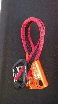

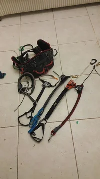

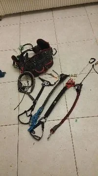

Ok...I just went through all this thread.....and you know what...personal choice...I have them all including a sweet shinascender that Jo Hedger came up with and helped me make....after using them all you know what I choose to work with....my second generation HAAS....it curls neatly into a ball that hangs on my small caritool....never know it's there....smoother stiffer faster lighter multiuse...these words are used by different folk describing what they PREFER in a knee ascender....I choose practical...they are all functional and smooth to me....I do not rec climb...so for me at work that coiled up HAAS is what does it for me....trees here are not that tall so I am not looking for the knee ascender nirvana...just something that gets me up the rope efficiently and most of all stores nicely....2016-04-12 18.53.21.webp
