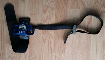

I am just an amateur climber, so I am a bit hesitant to expose my setup here to you experts, but hopefully I can learn something from your assessment. I have no experience with the SAKA – never even seen one in person – but I have used the original Haas. I liked the Haas well enough at first, but eventually I learned a way that works better for me. Honestly, I hate bungees and see no need for them in a knee ascender. It’s just one more line to manage, and the only reason it is there is to pull the ascender up the rope. To me, that is superfluous, when my leg is already moving upward at the same time, and the ascender could easily hitch a ride with it.
So I made my own knee ascender by strapping an ascender to my leg just below my knee and attaching a foot strap to it. When I raise my leg, the ascender comes right along with it. The best part is that there is nothing to remove once I get to the top and nothing to store. It stays on my leg the whole time, does not get in my way and is ready to go if I need to ascend any farther. Not everybody will like it, of course, but it suits me very well.
I use a wide Velcro strap like the ones on the SawPod (https://www.treestuff.com/store/catalog.asp?item=1387 ) to hold the ascender to my leg, and I find it very comfortable. I use a common lashing strap that I girth hitched to the bottom of the ascender, and I created a footloop by positioning the buckle just above the top of my foot and running the strap through the back of the buckle, around my foot and back through the buckle where I can quickly adjust the length and tension. Honestly, my cheap homemade rig does not hold up as well as I would like, but I used the same setup for a year before it started looking pretty ratty and needed a re-do. But then I don’t do nearly as much climbing as you guys. Those of you who know how to splice a rope or sew a strap will easily be able to make a better and more durable one.
So if you asked me to recommend the SAKA or the Haas, I would say neither. You may be able to make something better for cheaper.

You're right. I overstated my case. I should have said that I dislike unnecessary bungees especially when, as in this case, it also creates the need to disconnect and store the Haas.
Regarding alignment issues, I can only say that that sounds like it could be a problem in theory, but in practice I have not noticed any problems. But that could be just because I am too ignorant or naive to notice.

I think Reed is talking about this:
Great post. Thanks for the links. This looks like the easiest and fastest way there is to rig up a knee ascender setup. It's a great idea; credit to whoever thought of the idea of combining those pieces/parts together in the first place, and you for passing it on here on the Buzz.
