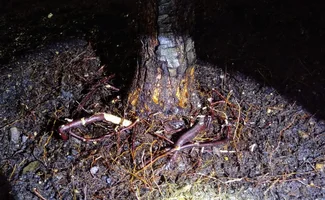

I just planted a Monterrey Oak and it doesn't have much visible root flare. It was in a 30gal container and is maybe 9 ft tall.
I would have already excavated, but there is a fairly dense mesh of fine roots all the way up to the soil surface. Should that be excavated away, or left alone?

I found the flare a couple inches down. Planting height looks good.
There is definitely some confusion in these roots. I'm going to read through that material before I go further. The root on the left takes a hard right turn and goes behind the tree (not down). These aren't the buttress roots though, right?
