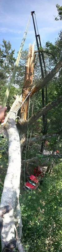

Here I took one white XRR sling. It comes with only one Large 28x20 ring spliced to it.
I wanted a sling that we could set remotely from the ground but take a lot of weight and have a large bend radius. Because this lightning struck tulip had a large hanger where I wanted to set up the crane truck.
It is very easily installable from the ground and the hanger was tied from the ground as well. hanger yanked out by chipper winch with a rigging line to control.
After THAT hanger was removed, I used the crane as a safe tie-in point and continued to use that sling for other hangers and limbs. Here are some pictures of the continued use:
