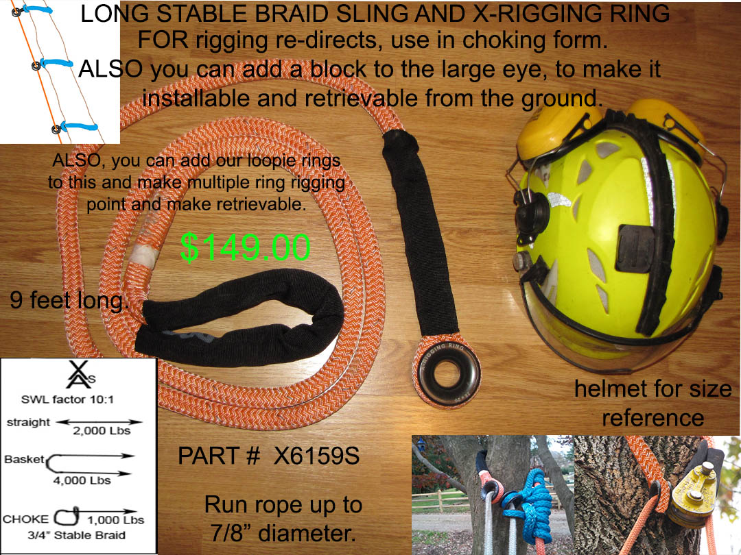

X-rigging rings
ummm, Bixler, he was asking if we put out anything bigger than 3/4". That is 3/4".
A good sling by ABR, not Xtreme Arborist Supply.
Cool the amsteel seem excessive but would be strong.
But david I thought you preached tenex cause of the heat. But I like the smooth db why the amsteel change of heart?
Not trying to rock the boat, just wondering?
Also does your new splicer make custom slings like this to order?
Yes, I preached tenex because of the heat. It's strong, not expensive and good heat resistance. Tenex Tec makes sense to use. I still think it would be a mistake to got with regular dyneema for the general public. I've taken readings of rings in the sun doing nothing but soaking up heat and they get to 120 degrees F and dyneema degrades at 150 degrees F they say. You can definitely get the rings 30 degrees warmer during rope running. hot day in the sun and using the rings can equal 150 degrees no problem, sounds like degradation is feasible with dyneema to me. We are not going to sell anything with raw dyneema for ring slings and I advise that others do not as well.
You were asking about even stronger creations, so, I thought you could go with amsteel II Plus. Notice the II (two). It has a jacket over it like a double braid bull rope, I haven't tested with heat, but this would very likely stop heat from getting to the dyneema. Plus it's freakin' ONE inch. 57,000 lb average breaking strength I think. I know a little about it because I bought 600 feet of it. Awesome crane slings we made out of it and great for a static guy line on terrible leaning or rotten trees. I might have 180 feet left on the spool not touched yet. Expensive as HECK!
KevinS, I see I didn't answer everything you asked: yes, this splicing company I'm very happy to work with does custom orders.
If you like double braid and 3/4" is enough, you could buy that ABR/treestuff one that Bix showed.
Or you could buy the original 9 foot double braid from TreeStuff or Xtreme Arborist Supply.
AND THEN if you wanted the same configuration as the ABR/TreeStuff One, you just Add the Extra large Beast 38x28 ring to the spliced eye, Then you have yourself the Ring and Ring like the ABR TreeStuff one, but you aren't limited. You can still make it a choking single ring redirect. You also have 9 feet to your advantage. You stick the beast in that black chafe sleave eye you see above, then use some junk cordage to trap the beast in the eye.

x would i be able to get an XL ring spliced on to one of the 9 foot double braids instead of the Large ring? how much better do the tenex loopie slings hold on the longer tenex sling over the double braid?
Dmm,
Sure. Write us at XtremeArborist (at) yahoo.com
Put in the "@" of course.
"How much does the tenex loopie sling hold over the double braid? "
I'm not sure what you mean. Ask in another way?
