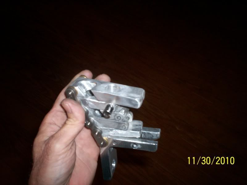

I decided to make a proof of concept unicender (for demonstration only).
The top clutch replaces the normal top attach point, and can be used as an additional clutch/attach point/rope wrench. When on SRT, squeeze the four clutch bars a usual and let the top clutch swing up and the rope will take an S turn through the clutch (which is radiused very smoothly). I have also incorporated a small steel roller in the bottom attach point (as others have already suggested), which does allow the slack to be tended nicely, as I am able to pull straight upward on the tail rope.
