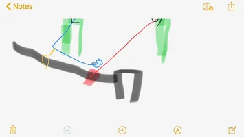

When rigging from two separate points, you can tie a Blake’s hitch with one line to the other. This way you only have to tie one leg each time, and the ground crew only unties one. Slide the Blake’s to gain enough tail to tie with, then slide it back down to the knot. I’ve used this with a grcs on the Blake’s side and no slipping.
Something I’ve not tried, but that came to me while sharing this- to get one rope in a different place on the piece for better manipulation but still avoiding a lot of tying and untying, incorporating a sling and biner could work by choking the sling where you want the load, and clip the desired leg into the biner. A little more gear, but still a lot less tying. If I don’t get to it first, someone try this and let me know. In this scenario, I would tie the Blake’s to pull downward toward the knot, so that loading would pull it toward the knot rather than away. Normally, I tie it so the tying tail is exiting the top of the hitch, but I’m not sure how things might change, if at all, with the deflection of the sling and biner.
I've done that before and it didn't really work the way you expected. The biner and sling slides down or up the rope depending on how the balance on the piece is and behaves much more like a running bowline with a half hitch above it, than like a spider leg.
A midline Alpine or a figure 8 on a bight that the biner is clipped into makes it behave like a spider leg.
Off topic to that, the shizll spider slings or a diy alternative with a rigging plate and prussik and a pair of steel biners on the balancing legs makes a very easy, very quick balancer setup
I’m wondering if we’re describing the same thing. My goal is not to spider leg. The initial idea, which was pictured, just puts two ropes on a piece when using two rigging points, whether it be a rigging point in another tree with a brake line in the tree you’re climbing, or rigging a “y” to it a drop zone between stems.
The second idea (which may be the one you’re referencing?) was to redirect one of the lines down a branch, so that one is simulating a tip tie in addition to the butt tie. I’m not attempting a spider leg. In general, they tend to be more work and too involved when smaller pieces works just fine (my opinion).
Here’s a quick attempt at illustrating my thought to see if we’re talking about the same thing.
Different things, yours should work as you drew it. I was assuming only 1 line.
I think I know what you’re referring to now. What if you tried opposing munter hitched on the biners? There’s still a chance they would just slide, but less chance (I think).
I’m considering more sling use in rigging. I’ve toyed with knotless rigging setups before, but haven’t stuck to them to see their efficiency in varied situations. Since buying a rapid rig and seeing its value, I’m more open to trying more things like the backbone mini and other sling-happy systems.
