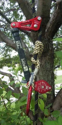

Well... today this came...
So, I had to give it a try...
Rope: KM3 Max 11mm
E2E cord: 8mm Beeline
Hitch: 4-wrap Michoacan
Weight: 185 lbs.

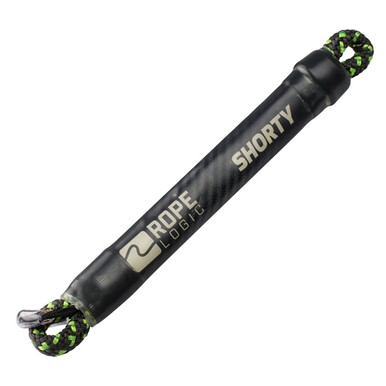

A few runs up and down at 40' tells me this is a winner. Performed flawlessly. Swapped the Beeline out for Epicord 8mm and performance was similar... but I like the Beeline better.
Now your talking Mr Gu. 11mm climbing line, 8mm hitch, a shorty tether, and a Michoacán. A Wrench at its finest..
Where did you get the shorty tether?
