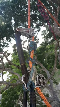

I got these two setups working good today on km3 13mm. Rit on the hh2 straight valdotain and hrc on the wrench with a micho. I'm about 175 with no shoes or gear.
View attachment 62101View attachment 62102
Ok do yourself a favor. Ditch the pinto. Get a hitchclimber. Buy an @height shorty double leg special order at wesspur. Tidy up those tails at least. Nice of you to get wrenching. You can PM me a special thanks at anytime. Buy some stitched eye prussics.

Whats better about the hitch climber? I can get a shorty double eye from Gap. The tails are long because I am getting my length figured out. I will splice myself an eye and eye. Maybe order stitched. We will see.

Sewm eyes works way better than spliced eyes. Been up and down that road for eight years. The center hole of the HC is the perfect tending spot ....you can put throwline loop in the bottom of that extra long tether and it will work albeit off centre...

Yo Swing, Gap keeps the ISC shorty's in stock.. Agreed that a Wrench seems to perform better on a HC than a Pinto. Cant really figure out why, but it does.
I hesitate to buy an hc because it's $60 and if I don't need it, then I could use that $ somewhere else. But hey, I could use my pinto somewhere else, I just threw it on because I had it. Then I gotta get another $25 dollar tether, but the broom stick is unnecessarily long, lol. @swingdude, I see your point with the tending spot. I was using one of the holes in my cali swivel to tend, which worked just fine, but does give one more biner length of slack. Not accualy a big deal, but if your nit picking your system for max efficency, it's something.

When it comes to which pulley to use, I think it depends on how your tend your hitch. I think the HC is best when your pulling your climbing line straight down instead of using the sheave and pulling up or outward.
I haven't got the rapide yet and I'm will soon bc I love bearings and that might make the difference but for me I've found that the pinto just breaks the hitch effortlessly especially if you use the sheeve to pull your climb line up or outward.
I do love the extra hole on the HC for a chest connection but you can connect your chest to the Becket of the pinto too.
The pinto is much stronger and could be used for many other applications that the HC pulley would not be as well suited for.
The pinto is also lighter than the HC.
I really need to get the HC rapide and the pinto rig bc I just love how smooth the bearings are compared to bushings.

I am not far off bro. I almost ordered that hc pulley last night, but I saw someone had both eyes of a double eye tether on the inside of a pinto so I decided I will try that, with the new shorty tether and the stitched eye to eyes I ordered, lol. I'll get the hc sooner than later I'm sure. It's weird, after 17 years as a pro tree climber, I'm more excited to climb now than ever before. I rec climbed this 130+ ft hickory yesterday just to mess with new gear and "practice" cause I'm planning on competing next year.
Pintos are some of the best hitch tenders man. And their also perfect if you MRS Too BC when a doubled line is terminated on the becket, it keeps the pinto in the perfect position to move your hitch.
When you have the HC pulley, it takes a little more effort to tend when pulling anywhere but straight down because the pulley has to turn into position to move hitch upward.
I know it seems small but I just love the pinto for how responsible it is when tending hitches.
