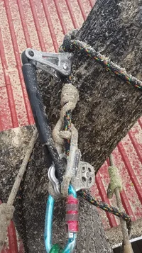

Been running the ISC short tether with the little rubber chingadera on the Wrench end removed, and it really makes the Wrench tend like a dream. You can see by the 1st pic that without the rubber piece there is basically zero bend in the rope during accent, which means near zero friction created during ascent! Freakin' love it!

I was thinking about doing the same thing but I don't know how to do it with the fix tether without fuckin up the shrink wrap.
Does it still engage itself when u stop ascending or do ya set it by hand?
It still bites perfectly when I stop and sit in my hitch. With a Michoacan it's one high performance setup!
