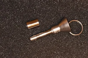

To address a couple of questions posted re: availability of the bushing for others, diameters etc.
We are currently looking into having these bushings manufactured. Luke at TreeStuff.com will have them if there is interest and we go through with this.
The outside diameter of the bushing itself is the same as the original set-up, e.g., 1/2". Therefore Kevin's design specifications are maintained. The inside diameter is 5/16", oversized a couple thousands to facilitate easy insertion of the pin. This then is the same as the original so the inside hole accommodates the removable pin that is available through Luke.
Tolerances of my bushing are close to be exact, there there is no slop in the bushing/pin interface. Does it rotate? I don't know the answer to this questions, however with a sliding load on it, it may. My testing, albeit limited because I don't climb every day like many of you, is limited.
I don't want to imply the pin itself is unsafe, especially if one is using a pin with a known rated shear force. Nevertheless, if there is going to be a failure, it would be the result of the pin bending. The bushing distributes the load in such a way that one is dealing with shear forces that would have to fail to be catastrophic, highly unlikely. The other thing it does is maintain the spacing between the two points as originally designed.
Eric
I actually prefer the pin with no bushing, it increases the bight in the rope and takes that much more friction off of the hitch. I have been wrenching for over a year in all the various stages of the wrench progression, and I believe the pin offers the best response. Not tryin to diss the bushing mod, it looks great, but I really think the pin alone is the cheese.
As far as the pin being less safe than the bushing mod, if something catastrophic happens, the waist belt on your saddle is gonna break ur spine long before a metal wrench fails, IMHO.
Either way, mad props to Kevin for all his time, dedication, and extreme efforts to bring the wrench to production, and to treestuff and the other retailers now carrying it for embracing what I consider to be a glimpse of the future of tree climbing.
Wrench on!

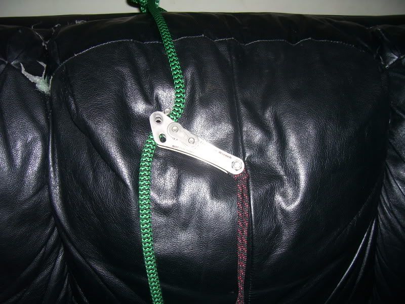

Here is the mod I made to the rope wrench to make it mid-line attachable and no pin to remove or lose. The roller is on the bottom friction point. In my experience if the roller is on the top friction point it will reduce the friction generated by the wrench. The side plates are 1/2" apart on this mod.
Giving this setup a go-
Thanks Rich H for the thimble idea
Kevin- Cheers for the pin
As soon as the cord length is dialed,
out comes the hot knife
Whats the thimble for? I've been paying attention to this thread. Did I miss something. Is it for attaching to an ascender to pull the hitchclimber up?
Yes
That is slick.
