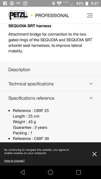

I'm not picking on a particular producer just making a point, seriously a three-year? It truly is about inspection.
And along the lines of what Andrew is talking about, and again I'm not picking on corporations, but I think somewhere in there is an accountant sitting at a desk that says our rope Bridges need to sell for about 20 to $25 or does not worth our effort, make that happen.Screenshot_20180712-092720.webp
