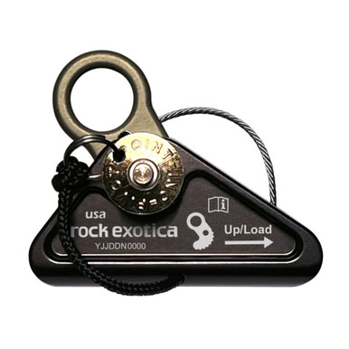

At least one rope grab has a quick release pin for easy on off the rope. The SS unit used on the Wraptor and elsewhere. I would feel good about using up to 1500 lb pull. I have one on a Masdam rope puller and the Masdam itself goes to full slip at about 1200 to 1500lb resistance.
that would be the Gibbs or similar, which do not release under load.
Gibs or a canned device that has a concave rope channel and flatter cam. Others pinch the rope and cause failures at fairly low loads in any rigging setup that may experience a shock load.
Petzl’s older micro grab was a ok one with a 1/2 limit. Those will slip before breaking the line (done it more than once).

Looks like there are a couple of easy on/off still out there being made.
Smc has another one.

I have a Rockgrab 90 0.625 (the big one 13-16mm) that I modified with a quick-release pin to use for my fiddle block. It works alright. But I usually forget it in my bags of extra gear and just end up using a 3/2 schwabisch on 12mm prusik. Tried and true.
