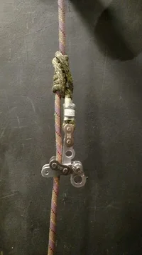

You could make that almost 2" shorter by using an endless loop rather than an eye to eye. Keep the stitched union oriented on one of the vertical outer bars of the Klemheist and find just the right length so a tiny bight remains at the bottom to attach to the Bone.
I have tested both the OAR and the Bone rigged with a hitch, and with some fiddling it works so-so. The HH is king of the Hybrid.
As to why the Bone engages with out a spring, I think it has mostly to do with the correct bollard for the size of rope. There needs to be a bit of friction on the rope.
Also when the top arm is fully collapsed the top and bottom links are in slight opposition, so that a bit of a bend remains in the rope, which in itself acts as a sort of spring,
also since the teardrop is offset the spine, it tends to tip the Bone when weighted causing a tension in the rope.

My Bulldog Bone has a little brother...and sister.
I'll quote myself from another thread:
I am really, really liking this lanyard adjuster. I have some video footage that I have put together to show off the BOLA...nothing special. It is just little clips that demonstrate the action...really smooth.
I don't have a gopro, so I was only using one hand...so excuse me for not looking very adept at operating my systems. I am finding more and more I like about this adjuster...the one thing it doesn't do is single line, but that's what its big brother is for.
PROS:
- One handed adjustment even while loaded
- Compact, fits well in hand
- Simple
- Smooth tending
- Grabs right away
- Single point switches seamlessly to tending
- Fixed or Swivel eye (Nano)
- Looks great coupled with the BDB!
*I haven't tried it in sap, but I am betting it would be worlds better than a hitch.
CONS:
- Not midline attachable (but for a lanyard adjuster that's just fine)
- Works on few lines/purpose built for 7/16 KM III (but for a lanyard adjuster that's just fine)
- Not for single line (but for a lanyard adjuster that's just fine)
Feel free to skip around and just watch what you want...I just wanted to get some footage out there so you all can see this thing move.
