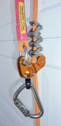

I also like to afford the splice some protection... from the mechanical device, the tree, etc. since it takes a beating by virtue of being on the end of the rope.
I prefer heat shrink tubing to duct tape, however... ;)

Ha - that looks pretty sweet actually. If I had some heat shrink (and a heat gun) - I'd do the same. Just using what I got for now. Is that clear heat shrink over some sort of red cover - with a label stuck in between? - Smart, clean, protected, identifiable.

...with a label stuck in between?
Yes, that's exactly what it is. Red shrink tubing, label, clear shrink tubing. Labels made with a P-Touch label maker (they're made by Brother). Don't buy the label cartridges from the local office supply store, though! Go online to P-Touch Direct and get them... much cheaper!
There are multiple labels on all the rope products... date included. Can't always see all the labels when I snap pics of the stuff, though. Good advice, though. :)
Here's other side, white label has date... pic is too fuzzy to read it, though.
