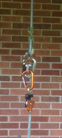

So I took apart the bottom half of the Bone and used it in combination with a friction hitch. This set up works very similar to the Hitch Hiker and applies friction below the hitch to work on a stationary line. A carabiner is going through the original tending hole which holds the legs of the eye to eye in place.
The correct size bow shackle would clean things up quite a bit and give a potential tending point. It works for sure, and tends beautifully. Though I need some time on it up in the trees. I think its pretty sweet. Just figured I'd share
You guys see any potential safety issues with this?

Here it is cleaned up a bit with bronze sleeve bearings/washers/slic pin. I'm hoping to find a quad action (like rope runner) slic pin with 1.5" of usable length....if anyone can point me in the right direction that would be great.

Looks cool Mike. Just wondering, when would you use this instead of just the bone? I love not having to deal with hitch cord anymore. And now, when I do need hitch cords, they sure last a whole lot longer than when I used them full time. Anyway, is there a use where this is better than the bone? Maybe on certain lines that aren't totally bone friendly?
"The Bone is Boss." I just like playing around with different ideas. But, for those who like the hitch hiker concept, this might be an alternative. That's it really. Just having fun
The Bone is Boss. I just like playing around with different ideas. But, for those who like the hitch hiker concept, this might be an alternative. That's it really. Just having fun
Totally understand the tinkering concept. I too am a fan. :) Just making sure I wasn't missing something important. Thanks.
Nice work Mike! At Jambo Chris Coates was doing something really similar with the rope runner and calling it the hitch runner. He dissasembled the bird and fit the hitch cord between the sheaths on the lower body and used a double slic pin to anchor the eyes of the hitch cord. It worked well and seemed smooth. I love new ideas. Thanks.
Awesome! I bet that works great with the runner.:guitarra:
I used this set up for a good amount of time today. I had to play with hitches quite a bit to find the right one. I think a little extra friction needs to be added below the hitch or else I can foresee them burning up quickly.
Something I have tried is three wraps of approx. 8mm between the lower and upper arms, tied to the hole in mid spine. Not so tight that it does not tend slack, and not too long so that it adds a bit of grip on a skinny rope when fully extended under the extended upper arms. That way when the upper arm is pulled down to release, it pushes the short hitch down also.
