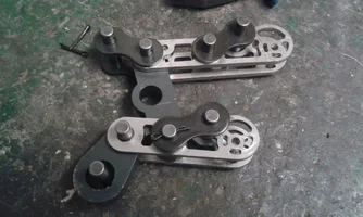

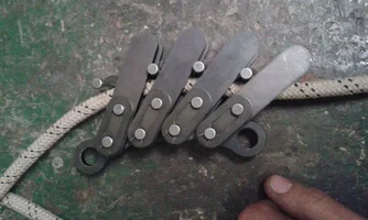

Maybe you should call your Bone the Skeleton. Is the Spine aluminum? Just be aware that without the nubs on the top release arm, there is a possibility of the top arm cross-loading with the bottom arm.
The four arm OAR will likely creep SRT, but should work DdRT, even with just two arms with Tachyon.
Whoa now. I .. I.. ..Anybody climbing on that Gordon?. Lanyard adjuster?What's it do ..:rebotando:
There is a UK climber that has been using a two arm OAR (without the hook ends) DdRT, for going on three years this summer.
He has customized the attach points. If you would like to see it, and the progression of OARS I have made, there is a post at
Arbtalk entitled "Bulldog OAR ascender/descender"
Yeah, lanyard adjuster ther Gordon. Have you tried that out?
