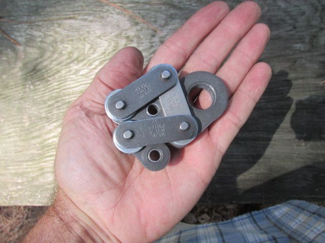

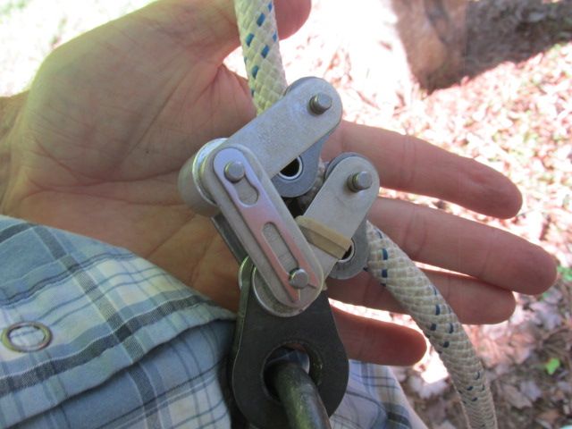

Here is a lanyard adjuster that has promise. You have to thread it, but it is quite compact and only 5-6 0z. even with all the high grade steel parts. It uses two modified size 60 roller links for the friction links. It will actually descend on a doubled line (on my small KM III) by pulling down on the bottom arm, while the upper arm acts as a smooth brake, on descent.
niiice,
looks good Gordon. that reminds me, I have to send you the old one. I will do that.
