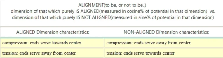

pic: same chart as above post#18
Either something of the same system/space is :
•in the same unique benchmark dimension(cos force and of cos patterns in left column of above chart)
or
•it is not(sin force and of sin patterns in right column of above chart)
To Be or NOT To Be is the question( yin/yang) and then the sum total of both's expressions in a system!

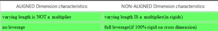

For rigids/non flexibles another slice of the that same previous chart focuses another category of forces in:
•the unique aligned dimension of force in the system/space(left side effects of chart at cos value)
or
•the not aligned parts(right side of chart effects at sin value)
(from: same chart referenced as from above post#18)
Again the cos/aligned dimension carries 1 force and force pattern;
while the sin /not aligned Dimension carries the other force(s) and pattern.

Notice in the simple models we have only 3 types of how linear input forces can be expressed:
•tension only (so is of the aligned Dimension in the system)
•compression only (so is of the aligned Dimension in the system)
•both at once (so is of the crossing Dimension in the system)
So even these force patterns are per Dimension, like cos:sin ratio; and the leveraged length clip of chart shown above. Everything is about if in the same Unique Dimension of the system or not (and how much so of each for cos:sin) as key factors. This defines how knots, rigging, hinging, leveraging, reaching etc. etc. plays out.
Relating to things by Dimension , it’s attributes including cos:sin value pair of how much of Same vs. Not Dimensions; has made me a better rigger, driver, knottier, worker etc. as i do things more purposefully to these powers, L-earn from that, and can see reflections of the same common principle into the other skills. For they are all facets/examples of this same lesson to me. So the knowledge, familiarity in one can be reflected into others; as they each re-affirm as echo each other’s same root functions in this model. To the point of seeing how could it be any different in rope, when even stars and microbes follow this pattern.

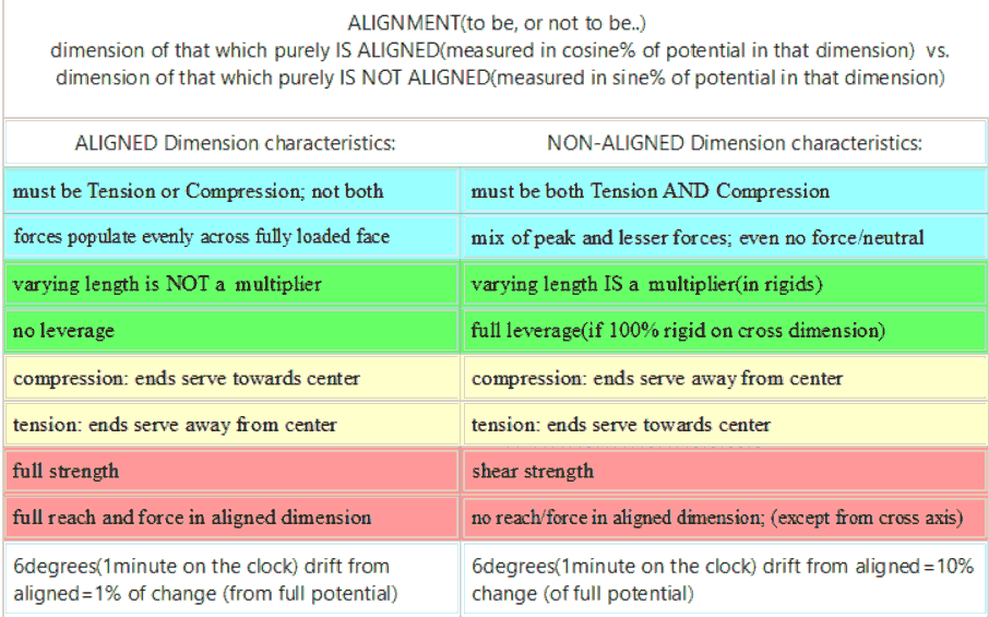

From the original table (from above post#18). i show this like this:
All the rigging, hinging, pulling, backing etc. etc. works by these Dimensional values of if something is in the Force Dimension vs. Crossing Dimension or not. And if not purely in either, then a mix of both to these patterns in the table, and values of cos:sin. i have an EASY mnemonic of cos:sin value pair rounded to the 'minutes' on the 360°clock; that is always with me to be my 'decoder ring' to constantly examine and re-affirm back these principles.
In the 'magic' of our rigging and hinging scenarios; this is the hand of the magician to watch to see the secrets as if 'behind the curtain'. Many other things can be the other distracting hand, perhaps say on the visible side of the curtain..

EVERYTHING hinges on if a force(or distance) is aligned in the same Dimension as the target perspective(support etc.) or not. Just like as to the same perspective of a person's view vs. all else, to then be the sum true total of all.
One facet to see this central truth thru is as an Eastern line of thought of IS or IS NOT as a yin/yang(as in sig); to then together define the sum of the whole happening comprehensively.
Then the cos:sin ratio in tables are the percentages of how much IS:IS NOT to reveal/define the whole of what is happening.
EVERYTHING has an opposite like this; a 'non' in these Eastern type terms.
Change, even as support against, we can define then as a rigid displacement against the opposing 'non' state, that's all !
Trust me Kenny, there are still folks around here like me (though I don't post as often anymore) who care and appreciate the hard work, time and effort that you put in to your posts! What dept. are you working in now?

Of the patterns shown for IS vs IS NOT in the SAME UNIQUE DIMENSION; the number scales and crunching would be the 'hardest' (even as tried to make them easy) to hold. The good (k)news is that once you grasp the patterns, they are not needed except for study; beyond what just will pop out from their familiarity. They mostly, as patterns, verify the looking at things in Dimensions, that have patterns; AND where the 'hot spots' are. Like in the overhead sweep of lateral to the side. Once realize that EVERY nuance/degree of spread in the sub 45°meridian range can be VERY helpful to the effort, don't really need to know the numbers so much for the decision at that point. But then at that point the 10%per minute increase of tension pull to the side is probably easy to remember anyways tho. Just as the numbers can verify why Tapered Hinge against sideLean is so powerful(even if that sideLean is downwards to a sideways sweep of a lateral); at some point after verified to follow the plan and do so, don't need numbers etc. Why center punch can help, why is most powerful with the tensioned backfield more centered in widest part of stump etc. The numbers can fade once have verified that we are correctly evaluating our past experiences!
Flexible devices as Rigid Displacements Against might seem counter-intuitive
Ropes are a flexible support device; meaning they may 'only rigidly displace against the non' on the inline axis of their length in simplest single models. But then only in the tension direction on that axis.
Because they have no native cross axis resistance, nor compression resistance in simplest single models.
Simplest single models meaning with 1 anchor and 1 load. In more complicated models like pulls at either end then cross loaded we can then see a cross axis resistance of lever (but w/o the distance factor). Also, the tighter the inline axis is, before cross loading, the less rubbery the lever is for more output from cross load. Another consideration is binding is in itself a 2D model, different from 1D Hitch or Bend usages of 1D in overall length view of the system. Dimension, Dimension, Dimension....
Rigid devices as Rigid Displacements Against work in all Dimensions and Directions in those Dimensions
Rigid devices and supports are different in that they have inline AND cross axis resistance; AND in both compression and tension directions on both the claimed axises. So, it is considered easier, more intuitive, to model/imagine rigidly displacing against the non benchmark Dimension or not values as shown thru out above.
cos:sin pattern is so completely , organically the right pattern, it can take us from 1D to 2D, and then 2D to 3D!!!
Another note, not to confuse, is that cos:sin progression as handed down from the Ancients can take us from a benchmark of 1D to 2D accurately as shown. BUT the given pattern is also SO PRECISE; if can define a full 2D model accurately, can then calc the 3rdD just as accurately from the 2D benchmark with SAME cos:sin value pair models. We don't have to do that for what we do; i just present to offer to have that much dead azz confidence in the system as throw forward in this yin/yang view !!!
Rigid Dimensions
In a rigid support , like tree,
1D scenario is when the C.o.G.(Center of Gravity) is directly over the base or hinge (like in telephone pole example)
2D scenario is when have lean from perfectly round support/stump. C.o.G. can be in different places around stump, but as long is same weight, height and angle scenario is the SAME, just Directions of Lean.
OR when hinge, if C.o.G. is squarely in face or backwards from it(or in theory/not practice if all sideLean).
3D math scenario comes into play when hinge and sideLean. So has inline force, force across hinge and to side(3D's of consideration).
Note that a round device is unilaterally equal in all directions,
BUT a linear (like hinge) is specialized to 1 axis, so only 2D when C.o.G. is squarely across thinnest or widest part of hinge. Thus this is just 1 example of how important Linears vs. Radials are in this Dimensional modelling
The Dimensionalities are very important in that force parts in the 1D aspect can ONLY be supported with a 1D pattern of force.
Whilst forces in the 2ndD can ONLY be supported by that force pattern;
then too the 3rdD forces can only be supported by patterns and forces within those patters that address that 3rdD ONLY. Thus a Tapered Hinge gives stronger sideLean support because it asserts a large amount of fiber directly opposing that sideLean's crossing Dimension.
Dimension, Dimension, Dimension..is all ways and always key hear.
Distance does not matter in 1D force parts; only in the 2D and 3D force parts.
force volume =weight X (Distance from Unique Aligned Dimension of 1D) or just weight in 1D aspect.
as go outside 1D will see Distance from Unique Aligned Dimension of 1D = Distance to CoG xSine (as drift from 1D)
