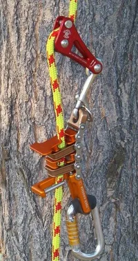

If I were to run it that way I’d have the wrench on the biner and not the tending hole. It was more of a smart assed jab, but it really is something to try.
So day one thoughts are it’s fucken awesome. It worked great for the first half of the climb, then it became jerky. This could be because my rope started getting moist, or the tail weight changed the friction? Granted I could have had it snug, wasn’t exactly a low and slow job, but wasn’t a 100’ climb either
This stands to reason, that using the RW with the Akmbo, might enable the Akimbo to be used on smaller diameter climbing lines. I just might have to test this theory, since many of the approved ropes are out of stock and/or unavailable.
I wouldn't think you have to worry if the ropes are approved. Use whatever you currently use and see if it performs well.
See if it holds you, climb up, check if it holds a few times, try a short descent, see if it holds, if it does consistently, try a long fast descent and see if the heat causes it to start slipping.
That should test your rope's suitability and your akimbo adjustments
...but I've never even seen one
Just to be clear I never even used it in that configuration. It was more of a jab at the instructions and the tending hole not being for life support.
Now if one were to slap a wrench on it I’d just place it on the main carabiner.
We've all seen the pictures of the Wrench siitting on top of just about every device out there, and I even saw a photo of a Wrench over a hitch-hiker recently. With some tweaking of the settings I imagine the Wrench/ Akimbo might work really well for some. Who knows? A real testament to the simple genius of the wrench. Thanks Mr. TreeBing!
