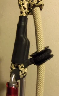

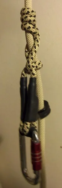

The Brocky Thimble Tender on a lanyard... super lightweight, works great. I used a 3/4" long piece of 1/4" I.D. rubber tubing between the carabiner and the point where one loop of the tether goes through the other one... on the "throat" of the tether. This keeps the tether from loosening up and the thimble falling out. It acts like a spring pushing against this tendency.
Thank you @Brocky... I've already got a bunch of ideas for more versions.
I should mention, when using these sewn E2E cords, this works for hitches that don't actually need the tender to touch the hitch, like the Distel hitch (shown) and many others.
Tying the legs together just above the sewn area and using a longer tether, that seems to just rest until needed on the velcro strip used below, and pushes the hitch right away. This gets the thimble right under the hitch.
