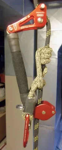

I just set up the red RW stuff with the 26" Beeline and yeah, I have about an inch on each leg that I don't need, so the 24" one should do the job. Shorty tether and KM3 Max 7/16" rope.
And, I have a tube of 5 minute epoxy and a buttplug for that baboon, too.

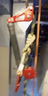

Sorry about the fuzzy pic. Looked fine through the viewer and the bottom of my beer glass. No idea what happened.
That setup looks sweet. I dont know if your used to running a 4 wrap Michoacán but it can be a quick slick mutherfucker when loaded with the down legs directly over the pulley hole. I freaking love it that way, but if its too much flip the hitch 180% and it will bite in quicker and better. Once that HRC is broken in a little you should be rocking a seriously high performance setup with almost no setback.. Plus a black Wrench on that black KM is gonna be pure stealthy sexiness!
