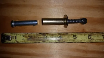

I just got my RR in Dec. while it was still warm up here in Vermont. Now that the cold has finally set in I really see the need for a Slic Pin key. I think I saw where TreeStuff has one in the works. But until they have that to offer I thought I would see what I could use in the meantime.
Here is what I was able to put together from a spent 30-06 casing and less than $5 of stainless hardware from the Ace Hardware store.

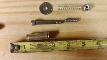

I used a stainless socket head screw that had a lot of unthreaded shank and cut off most of the threaded portion, a stainless fender washer, spring (not stainless), and a Stainless Nyloc nut. The empty bullet casing is from a 30-06 that was shortened and works pretty well but if there is something a tad smaller it would work even better.

The next step will be to incorporate some sort of tether to the washer so as to be able to attach the key to either my saddle or to the RR. Also need to find a bullet caliber that is slightly smaller and perhaps a stainless spring.
