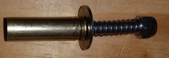

I just got my RR in Dec. while it was still warm up here in Vermont. Now that the cold has finally set in I really see the need for a Slic Pin key. I think I saw where TreeStuff has one in the works. But until they have that to offer I thought I would see what I could use in the meantime.
Here is what I was able to put together from a spent 30-06 casing and less than $5 of stainless hardware from the Ace Hardware store.
I used a stainless socket head screw that had a lot of unthreaded shank and cut off most of the threaded portion, a stainless fender washer, spring (not stainless), and a Stainless Nyloc nut. The empty bullet casing is from a 30-06 that was shortened and works pretty well but if there is something a tad smaller it would work even better.
The next step will be to incorporate some sort of tether to the washer so as to be able to attach the key to either my saddle or to the RR. Also need to find a bullet caliber that is slightly smaller and perhaps a stainless spring.

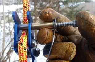

Forgive me for not being able to see this, but where is that nylock nut located in the final product, and is that what keeps the spring-loaded socket head screw from popping completely out? Is it up inside the spent shell casing?
Thanks in advance for any answer you choose to provide. Nice design, also.
Tim
Hi Tim,
First I drilled a 17/64" hole in the end of the SPENT bullet case. Then installed the 1/4" socket head screw though the casing so the head of the screw is inside the casing and the shaft is extending out the end.
Next goes the washer then the spring and finally the Nyloc nut. The nut acts as the end of the plunger I push with my thumb.

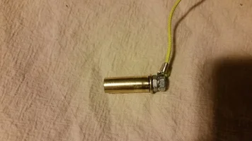

I took your bullet casing idea and ran with it. 30-30 winchester fits the slik-pin perfectly. This is more like the John-Kays design with the spring on the inside.20160124_202515.webp
N.e.Tree, I just got a hold of a 30-30 Win. and found it to be too small for the Slic Pin used in the RR. Are there different sized 30-30s?
use the right sized drill bit and you can drill a hole in anything to make a slic key. an addition of a bolt and nut for a plunger works well. plastic, wood, metal, nylon. a piece of bungee for a leash.
Not that I know of. I got a few I can send you if you'd like
