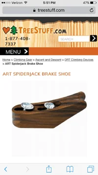

Okay so a few more people have asked about more of these. I am looking but not having much success finding any still around. I can certainly get some more made but for those who have them here is my question... Is the thickness okay (@1/4") or would you like them better if they were about (@1/8" or 3/16"). Also would you prefer Plastic or rubber over the wood. They all have different material thickness but some overlap. The prices all vary considerably so I want to choose what the people like best. Thanks.

I think they're great like they were frank

The wood ones have been fine for me, I sanded the edges down a bit, they have held up fine, I mainly only use my RR for pruning so doesn’t get dinged up or anything.
How about Handroanthus, called “Ipe” in the construction world. Find a contractor in your area building a deck with it and grab some off-cuts. Stuff’s incredible.
