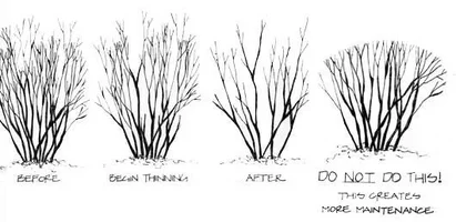

However, I might express a opinion, which expands upon my earlier comment regarding shrub pruning aptitude being reflected in a quality tree canopy reduction.
It drives me bonkers observing the effects of landscapers wacking away at Burning Bush, Purple Sandcherries and other woody ornamental shrubs with gas trimmers. The result is like the fast right of this;
(aren't secateurs cheaper than gas powered hedge trimmers anyway!!)

Texture in hedges is very black and white. A hedge trimmed often and velvety is very fine texture and very little head back ability. A natural cedar that is stressed often has a very coats texture that can be headed back to almost the main stem. Cedars by the way are far more resilient to heavy reduction than many tree guys believe. For specific goals I've cut two thirds off the top and without one out of twenty showing the slightest stress. Back on track. Norway maples often look like round overs or even square round overs to begin with. texture in these becomes more coarse, whether you apply natural reduction or heavier reduction. But texture in poplars is often finer after the reaction growth fills in. And this texture can be thinned and restored on the second app.
