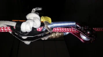

Yes. It works as a corner trap. Easy on/off. the spring is stiff enough to stay in place when unhooking. Thinking about painting it red and calling it the X-Spring.;). I tried yoyoman's shackle, then I found this. I also use the spring with my hitchclimber setup.
I did like the shackle. I like the spring idea too. I have a couple Rhino biners for cases where I want to control rotation. Of course they're aluminum so not much good in this case.
The shackle requires a mod to the bottom 2 screws to work without hanging up. The springs are cheap works great with the steel biner. I don't think the Rhino will work as good. I was about to give up on the HH then I tried it with the spring and pulley. This new tending idea look great and spring may not be needed. Is the material formed using heat?
Yes, the material, Kydex, is a thermoplastic which is formed using heat. By the way, the shackle I'm using is a wide D, and there's no need to modify the screws on the HH. In this version, I've drilled the holes to 5/8" rather than 1/2" to accommodate the carabiner which is supplied with the HH.
