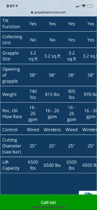

I’m such a huge fan of the Grapple Saw, that I really don’t take the stuff that big. Even though my crane is good for tens of thousands of pounds in some positions, I know that the Grapple Saw is not. It doesn’t seem to me like it would be saving time to take to Grapple Saw off just to take a huge log then put it back on to start disassembling another tree. I guess if it was my last lo of the day and I just needed or wanted to take it very big I could but there’s no point in me taking itMore than five or 6000 pounds anyway. I need to leave it in manageable sizes for my grapple trucks.

So your grapple will only grab and hold 4000lbs for the 280. Also if your saw is on a manual pull out extension the rating of that extension is all you are good for no matter what your load chart says. Lots of people pushing limits really hard with the manual pull outs, either that or they were never told the chart for the crane is worthless when the manual extension is out. So if your pull out is good for 2000lbs then even if you are sucked all the way in on all your booms you are still only good for 2000lbs. The weakest link in the chart has to be figured. There is no extrapolation on charts. If you have 5 1/2 fly extensions out, you have to use the chart for 6 out. If you are between 70d and 45d you have to use the 45d chart. Now if you have the 280 on a hydraulic section then you are good for chart minus 880lbs. It weighs 880 full of bar oil and hydraulic fluid with a 20" bar on it. I see guys all the time lifting thousands of pounds with the grapple and I know what their manual extension is good for. It's just a matter of time before these guys start breaking off manual extensions. The trend started when Bluestone started doing it. Perfectly fine because their manual is good for like 3 or 4 thousand pounds. I see guys doing similar with 30 and 40 series booms and some 50's. You won't see me pushing those limits. I feel like its careless and unnecessary punishment to an investment and jeprodizes lives and property. Bluestone has the equipment to do it safely. Its not them I take issue with. Look at all these IG and facebook videos. Look at the guys taking huge shit with a manual extension rated for 1440lbs and a saw head that weighs 880lbs. You do the math. I'm not mathematician but 2000lbs isn't the remainder when you work the equation. Maybe it's just me but I think the load chart is there for a reason and it should be understood inside and out before anybody goes out and plays crane with their new toy. Mark my words. It's only gonna take one huge fuck up and the powers will be up the ass of the grapplesaw crane so far the corporate officers of the companies making them will hurt to sit down. Its a false sense of security. If you overload a stick crane it tips over. When you overload a kboom it bleeds off pressure and goes to the ground or snaps the boom. So please know the chart and know if the configuration you have your crane in is good for the capacity based on how its set up, not necessarily the load chart. This is all stuff the manufacturer should explain and because there is no LMI these guys have no idea how far over limits they are. Thats why I have a load pin and a load block. I can't afford to buy one every 5 years because it beat the shit out of it.

4000 squeeze pressure is what I was told and can find in my book. Look on the mecanil site and tell me anywhere where it says lift capacity? It’s not there. Not slamming Todd but his site is the only place I’ve ever seen a number. So to figure what it can lift you need to know how much it can squeeze -4000lbs, what’s the rotator rated for and the bolts holding it on. Also what’s the pin good for? Formiko has rotators from 1t to 6t d pending on the model. Honestly I’ll have to look it up. My dealer told me it squeezes at 4000lbs pressure. That’s all I need to know.
