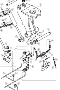

Can you tell me what part of the image the part is on?
Part 35 is the pump. It has a hydro line and the oil discharge line. Internally there is a piston and spring. The plug on the side opposite the mounting side protruded into the cylinder and deformed the piston, jamming it preventing function.
I appreciate the info. Took the pump apart this morning. The piston is not returning, it stuck out. so it’s not pumping fluid. Another one is being sent to me. I should have it tomorrow.
