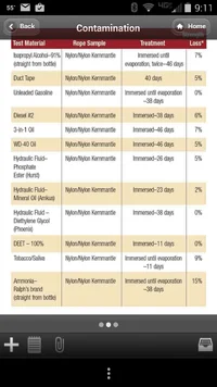

...the thought of spraying down a lanyard with WD to clean the sap off sets my spider senses on edge. I am crazy?
Well, I do that mostly on the hardware and the steelcore fliplines... all of mine use air hose instead of rope on the outside. Doesn't bother that stuff, at all. In fact, it actually makes it look new and keeps it from drying out. I've gotten it on Arbormaster and XTC rope lanyards in the past, while cleaning the adjusters up and it didn't seem to hurt it. I remember getting a rag wet with mineral spirits and wiping them down on purpose, to get pine sap off of them, then rinsing them off good with a bucket of warm water. That didn't seem to hurt them, either, but I ended up switching to the homebrew fliplines on sappy trees because they're so much easier to clean up and pretty much impervious to solvents.

Could you explain the picture? What is that material?
It is from the CMC rope rescue feild guide and is part of the rope contamination tests. Shows the type of rope used, the kind of treatment it received with various materials, and how long the rope was exposed to those materials such as, three hour inmersion, 57 days, 40 days, etc. then how much strength was lost.
That is terribly enlightening. Thank you very much for sharing that info! I'm going to be saving a ton of time cleaning sap off of rope!
