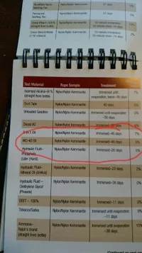

Carry a can of WD40 in your ditty bag... one of those small spray cans... best thing I've found to get sap off stuff in a hurry. I buy those 10 for $2 washclothes at the Dollar Store and use them for rags. Wrap one around WD40 can and into the ditty bag. Also gets that damn glue off that stickers and price tags leave behind. Also works fantastic on asphalt/pitch, in case you fall onto a hot tar (BUR) roof... or something... or maybe hit some tar sands bitumen with the stump grinder... or get tarred and feathered... hmm... out of ideas on the tar thing. Anyway, the methanol in that stuff is strong solvent, and the light machine oil doesn't hurt the gear any. Wipe it down a bit so the sawdust doesn't cling.
Anyway, I don't like leaving that sap on stuff, either.
I was always under the impression to avoid putting hydrocarbons on rope as much as you possibly can. I mean....I know it's going to see incidental contact with 2 cycle mix occasionally, but the thought of spraying down a lanyard with WD to clean the sap off sets my spider senses on edge. I am crazy?
