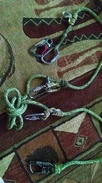

i have 2 lanyards, a 5m and a 15m, both kernamantel and with alloy hooks both ends. The short one has a dog snap in the middle and the long one has 2, these just for scooping em up midway to the tool loops and keeping rope out of my feet. My adjusters are two old grillons with the screw taken out so I can swap them between the two lines real quick depending on the tree. I know 15m is a real long lanyard but we get real big spread eucs and I'll use it for a second climbing system all the time. Two grillons back to back is great, I use one on the forward ring and one on the side d like all you other guys are saying or sometimes clip one to the central tie in point like the grillon manual says for single leg operation. It is VERY difficult to get the grillon to release in this mode when its got all your weight tho.
In all honesty, I got fed up with carrying too much hardware on my lanyard, so I reduced my free end to just an eye on the rope and a prusik, and there is a trick that does not require a pulley to ascend the prusik, I'm sure it's well known though.

I just noticed the shrink wrap sewn eye comments, can you see mine on the pics? This is my third attachment point, and I'm super keen on cover only stitched or brummeled splices, bargain basement to do, the Prusik is a waste piece of only 70cm long, and is a great 60cm Prusik.
Black glued shrinkwrap is cheap, but very industrial and tough.
