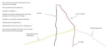

This is dangerous work. Here is what I would likely do. It is but one possibility and puts the feller at risk. The pull on the green line must assure that there is no trunk movement.

Just notch it away from the tree its leaning in , set the hinge with a bore cut, release the backstrap and boogie into the woods on precleared escape route.
the force of the top pushing back on the low stem should be plenty of force to get it moving as long as the hinge is weak enough. and the top is not hung up.
worse case scenario set a pull line on the high side of the break and cripple the lower stem with same cut, and get out first, pull with truck ot loader.

The only reason you'd need the rope in the top section is if the top was hung up. A close look at the way the branches are laying into each other should give you a pretty good idea of the potential problem there. My guess is with all that weight and it being dead for so long, the top will not hang up even if it is hooked.
You could get a sturdy rope 20' or less in the lower stem as a back up if the top didn't have enough to push the tree over, though you better know how to cut a very thin hinge with no bypass etc.
Yes I have been critical of your work and will continue to criticize your work without the need for name calling consider doing the same. I would have no problem climbing the tree the snag is hung in on the opposite side of the snag. What happens if the top comes free and goes side ways toward the electric meter after you cut the backstrap and boogie into the woods? I presented an option to reduce the potential of hitting the electric meter, never said it was the fastest or most energy saving method. What you suggests seems more risky and the outcome less predictable.

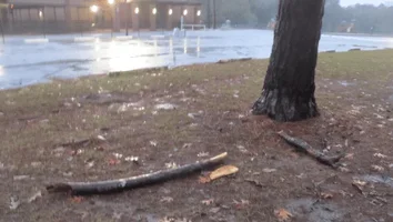

There was a similar situation where I didn't walk away, though. I noticed a dead limb hung about forty feet up in a tree at the local elementary school right down the street. It was in an area that sees a lot of foot traffic every day.
I looked at Google street view, and saw that the snag had been there for almost a year, so I knew it was probably rotten. I sent an email with photos to the director of maintenance at the school district along with an offer to get it down for free. I got a notice that the email had been opened, but didn't get a reply.
I was driving by the school on a rainy evening about a month later, and I noticed that the heavy part of the limb had broken free and shifted away from the small stuff. I went home and returned with the BS and some rope. I got the throw bag and line over the limb, and the limb fell as I was retrieving the loose line. It was balanced that delicately.

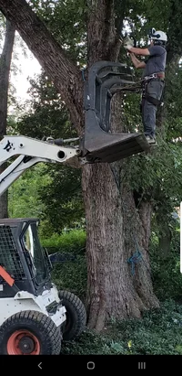

loader/tractor/African elephant
