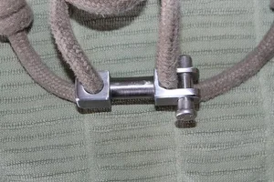

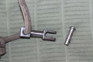

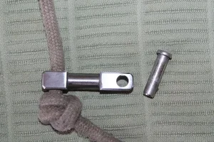

There was a guy at TCI that made a custom dogbone for the HH that allowed a slick pin to be used on one side, greatly improving the ON/OFF capability of the unit. Does anyone know him? Now's these time for him to chime in. The new unit looks pretty sweet.
That was my fellow co-worker (Aaron feather). He wants to get some more made and break tested. But unfortunately, the company he wants to make them only does like 100 or so at a time. Very pricey for the time and materials.
I'm with DSMc though, but untying those knots can get tricky sometimes.
I really, really like this. Looking forward to the new release, hopefully with the new style pin, but if not, I've got a friend who machines.
