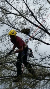

This is a dismantle of an American Elm. Two garages and four service drops split through the power lines. I felt I was so solid on work positioning hand tossed the brush out in tiny pieces through tiny holes. Then rigged out the wood.
