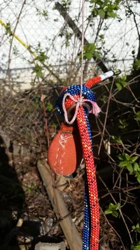

Kev, I find that utility eyes are best for installing lines, whether it's one or two simultaneously. I tried something like your photo on day one and had a miserable time. I had to pull in a second throwline and install the 2 lines separately in the same union. A bit of a pain before the climb but really worth it in that case.
