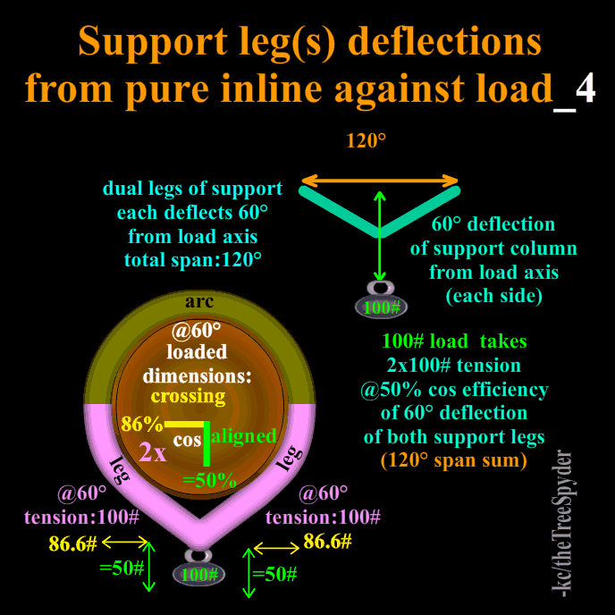

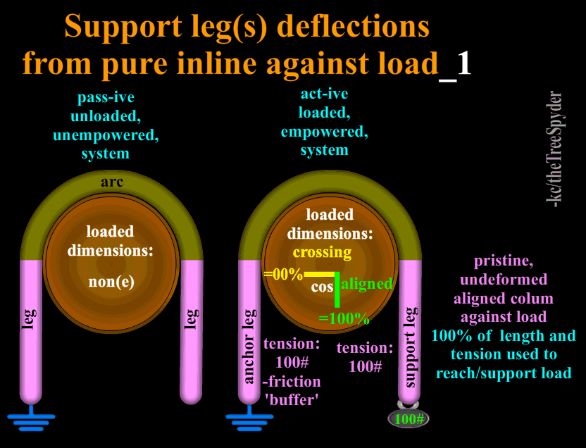

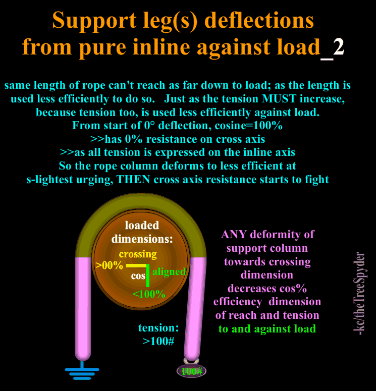

i think:
The more a given rope organically resists bend, the more bend radius matters against maintained tensile capacity, the more harsher an impact it takes the deformity from pure linear column of force.
>>larger diameter host also distributes wear and frictions/heat.
Also where linear forces calc by distance of linear as we easier visualize,
>>but these radial calc by degree of radial of how much of 2 different dimensions are employed presently, and the impacts of change as it 'rolls'.
As we deform from cos100% pure inline column, pure 100% tensile rating is lost/decreases.
>>If cos drops to 86.6%(@30°), only that percentage of tensile is aligned against load for support(like if only used 86.6% of the material column to start/less capacity for same reach); and the material tensile (and reach) drop to that new sum total of availability, while actual physical length and tensile are maintained for the material, just not accessed to the chosen dimension; and there is some byproduct to the then crossing dimension.
This is what tried to show in dimensional changes of Tapered Hinge against sideLean vs. normal rectangular 'strip' hinge.
counter-intuitively in terms of length(then to all else):
between benchmarks of cos=100%(aligned dimension 0° deflection from benchmark column)
and cos=0%(crossing dimension 90° deflection benchmark column)
>>the sum of both dimension effects is greater than the given potential distance etc. itself against benchmark dimension.
This can give great range of choices and effects of engineering.
Also:
>>Where reach attribute is positional to reveal benchmark dimension
>>While force attribute is directional to reveal benchmark dimension (by contrast)
Material X has peak potentials of reach, tensile etc.
>>if 100% aligned to reach positionally against benchmark axis
>>if 100% aligned to bear directionally against load as benchmark directional axis
Crossing dimension is ante/non(e) of benchmark dimension
>>forming own references of sideward drift(in distance terms) and leverage(in force terms).
Bringing Time into it, is impact of change, of ever increasing speed (til'terminal speed of self-parachute) SQUARED. As beginning reference some offer 1' of drop is static weight added again , then per foot multiplied as go, but at about 8' or so(100# x8' > 900# at this point etc.); the actual is really outrunning the thumbrule too much. So, anyway looking in that direction of impact of change from the static measurement to go dynamic w/time factor.
Gradual de-acceleration (vs. sudden stop) is reverse, kinda 'snubbing'(use word often picturing a boat 'snubber' to reduce wave shocks etc.) out force gradually, but at co$t of friction to try to keep in range.
1st one compresses it's rubber hose as it expands too; it all worx.
Peace

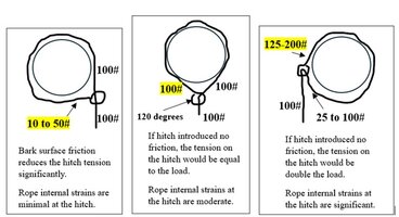

If this is true then it must apply to the hitch, where the rigging line is tied to the piece. Loading is same as the sling.
So if I tie onto a 100lb piece, then the rigging line sees 150lb at the hitch?
I apologize that my diagram of the highline forces sent this discussion in the wrong direction, I'll take the risk to add another diagram. Corrections will be much appreciated.
First, rigging forces are NOT like highline forces. That is because the rigging line goes THROUGH the hitch. The hitch is bending the rigging line. The rigging line is not trying to bend a highline. The following diagrams show range of 'bending' that we introduce, depending on where we set the hitch.
Second, because the hitch is able to slide along the rigging line and because the rope is able to stretch, the angles try to get as close to 120 degrees as possible.
Here are three diagrams showing the range of "normal" tension in the lines at the rigging points. At least, this is how I visualize it. Since I always try to simplify everything, I'm certainly missing something here.
If the hitch were not a hitch at all but a Pinto pulley, then the tension on the pulley would be a theoretical zero to twice the load. Zero happens in the first diagram above when the bark friction dissipates all the force. (Some arborists get close to this 'zero' when they wrap the log two or three times then connect back to the rigging line with a carabiner.) Twice the load happens in the third diagram above. In that case, on a Pinto pulley, it would act just like any pulley situation, with twice the load weight transferred above the pulley. Since we do use rope and not Pinto Pulleys, a lot of the extra force at the hitch is transferred to internal stress in the rope.
That's how it makes sense to me now.

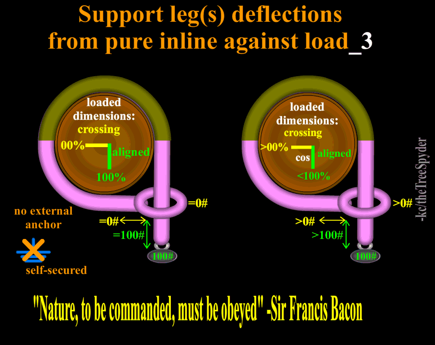

Like a battery to circuit, the wiring of rope and host are unloaded until 'lit' by the initiating force of the load, then trace geometry. Electronics can give changes and commands by circuit, geometry is the mainframe of engineering both mechanics and position. SPart(Standing Part) is the linear input/gas feed empowering the arcs of change/sliding cos:sine at the co$t of linear to radial conversion.
#'s reference picture in previous post above
>>not the pics added later to this post..
#1 can go around host 3x (or more a/n) usually and present no cross force as link/secure to SPart(especially if accidentally laces thru one of the Turns) , this is called Tensionless Hitch(no cross tension).
>>the more the cross force shows against column of SPart(w/less Turns) as sole support leg to give deformity from pure support column, the lower the cosine efficiency% of how much of tension(as an attribute now of the material) is expressed to support column against load dimension. Same for the attribute of length/distance, at same cos rate..
#2 Has deformity across against the sole support column of SPart against load, determining how much of tension and length of material is applied against load dimension. °This is a single leg of support.
>>IF dual leg of support like both ends of eye2eye as supports; not single leg of support eye2eye choked, THEN at 120°; have 2xLegs of support of 60°, deflections each from load line, so therefore cosine% efficiency of support is 50%, then x2 legs; YES calc each leg @ load tension x50% is 1/2, 2nd leg completes to sum of load.
#3The SPart input feed is = to load against, everything else is geometry, eye gets.than can only pass at most 200# if 180 bend thru it from the SPart to BackTurn type
edit/adding:
The same strategies work for distance and force etc.
But, they work in distance per positional attribute of material
>>as they work in forces per directional attribute of force /sender
or from other perspective per directional attribute of material/rcvr
>>either/or works: because force displaces against equal opposite to cross-verify with
>>whereas distance only displaces against freespace
