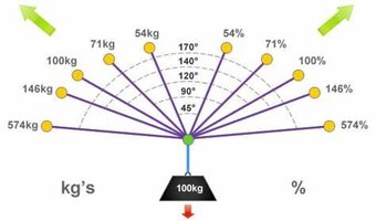

Using the numbers in the above diagram -
-- a 500-pound log held in place through a block
-- exerts 1,000 pounds of force on the rope/strap holding the block.
If that rope/strap is cinched very tightly to the tree and it takes a 95-degree turn at the cinch, rising only 5 degrees, then the force on that rope/strap is over 5,000 pounds.
NOTE: SEE FOLLOWING DISCUSSION WHICH SHOWS THIS LINE OF REASONING IS WRONG!

@Bart_ I'm wondering how the old sling angle charts from the crane industry translate into comparable examples with deadeye slings on spars in cow or timber hitch setups. I really hadn't thought about it before. I see how it would translate for a round sling of the perfect length stretched around the spar in a basket configuration,with both ends clipped together and a block hanging off there, but I don't understand the analogous
situation with a deadeye sling. Thoughts?

The numbers are based on forces of highlines and hammocks. I found two more diagrams (below) that illustrate.

(Artwork from "Working the Angles" by Joe Harris, published by Victorian Tree Industry Association.)
I've studied deflection angle charts before, but it never occurred to me that they would apply to deadeye slings. Deflection is a tensioned rope between 2 anchors, being pulled sideways somewhere in the middle...
It feels like deflection-adjacent to me, but not the same thing. And if it is the same thing and it applies to rigging slings, then it would have to also apply to the rope itself, when tied to a piece hanging in the rigging....

It appears there is a difference between pressures on deadeye slings and forces on highlines. Below is a chart for crane work with choking slings. Forces don't appear to be nearly as extreme as for highlines.
Muggs, your definition - "Deflection is a tensioned rope between 2 anchors, being pulled sideways somewhere in the middle" suggests that maybe I need to look at the situation sideways. The "tensioned rope" goes from the block to one side of the tree, and it is being "deflected" by the choking end of the rope.
Using that perspective, the numbers in your "choke angle effect" diagram above, and the following "choker hitch angle" diagram make more sense.

Another thing their diagram shows is that if you set the choke point right against the load/box, when lifted the choke point will slide and equalize out to a position more like they drew in the diagram. More complication.
Now if you set your block not centered but on the side like you're trying to pull start the tree trunk all the nice symmetrical charts and diagrams go out the window. That's pulling sideways (deflect) on a rope midpoint but no longer in a perpendicular direction, instead at some angle. The vectors can be solved, but at what gain for what mental pain?
I propose that establishing what tension amplification occurs in commonly used setups is where the value lies.
