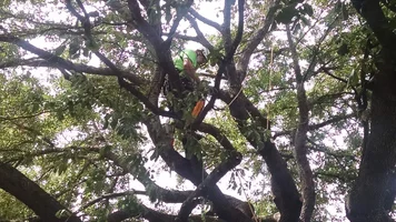

I'm doing one now that is about 30-35 feet tall and 75 feet wide. Here is a photo of one I did last summer.
Hey, oldoakman! Thanks so much for posting that photo! Much appreciated.
If it is not too much trouble, and the owner's of the Live Oak that you are currently climbing do not object, I was wondering if you could take a photo of it from far enough back to show the entire spread of the tree, from bottom to top.
I know that is asking for a lot, so it's ok if you can't. Thanks for your time, and again for the original image.
Tim
Did someone say live oaks? Redirect heaven
Hey, moss! Is that your rope in that Live Oak? Were you on a trip down south when you climbed it, if so? I had the impression that the Live Oaks were confined to the warmer southern parts of the country. I need to check one of my field guides, now.
If that was your rope, just how much of a blast was it, redirecting all around the crown?
Tim
