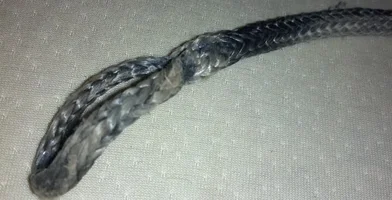

Let me put it in perspective. I've never heard anyone in my direct circle (50-60 full time Arborists?) mention being subject to a spontaneous failure of ANY piece of life supporting gear. I have two former coworkers that have been exposed to a large fall and injury due to bridge failures on the Cougar outside of the recall. Fluke?
Any piece of gear that can't take long term abuse of typical production without showing visual indicators that damage has occurred, is fit for the pit. Buzzers are big on inspections and staying up to date on products, but that crowd makes up about 1 in 10 in our industry. Do every Cougar owner you bump into a favour and install a backup.

This just in, another Weaver Cougar bridge failure today over on the mainland. 12 weeks old (the replacement bridge from the recall I might add), no signs of major wear, spontaneous failure. He's ok, was very fortunate to have it fail not far off the ground.
Unreal, and uncool. It's time for Weaver to step up and own this mess.

Out of interest, can someone tell me what make & model of cordage is used on these replacement bridges.
I'm unaware of current specs as i dropped this product altogether when this all first begun...but others are still selling them here.
Would i be right assuming that current new cougars would be running this same bridge?
Ok so if you guys have seen these bridges first hand you need to have this documented with pictures and verify which bridge it is and send copies with a formal complaint to weaver and OSHA, ISA, and ANSI. I'm sure there is some other governing body or lawyer that should be contacted. We need to get a formal count on how many bridges have failed new, old, and replacement. Lets be proactive; we can talk about this all day on here but we need to take action.
Any suggestions? Oh and if you know someone climbing on a cougar inform them of the issue and make them replace it. If they use the I don't have money for it excuse loan it to them or buy it for them. Whats the most you will spend on a bridge 75 bucks. I think my friends life is worth that much.

I apologise, I didn't mean any disrespect at all. I agree 100% that it is serious and that is why these complaints and failed bridges need to be sent to the right people. Action needs to be taken. In the mean time, I wish there were more pictures and the people that have fallen as a result of these bridges would come on here and chime in.
