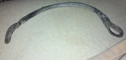

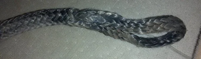

Would a four webbing strap round braided bridge build redundant safety and visual inspection into a bridge? Each strap could meet ANSI standards and if you didn't notice wear and one broke you'd still have three to go before falling. Attached example. Yes this one's a dog leash.
I think the 4 braid webbing looks cool, but if the webbing isn't around a core it will just flatten out. Maybe just go to something like the butterfly bridge?

Hey Bevin, that braided webbing is a neat idea. I wonder what the strength rating would be for something like that? maybe they could put a piece of cylindrical rubber in the center to keep it round and possibly absorb shock. Something like that rubber in the cobra cabling system.
