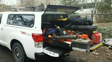

Nice. I have been looking at getting a cargo slide as well for some of my climbing/rigging gear. I got a commercial cap with toolboxes on the sides, perfect for all saws/gas/oil/wedges/and smaller nick nacks
Nice and simple Warthaug. Dig it.
Yeah those roll outs are sweet Worthaug. Seen them before and always thought what a good idea they are. Mind if I ask what they cost? And how long they last?
