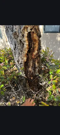

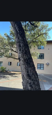

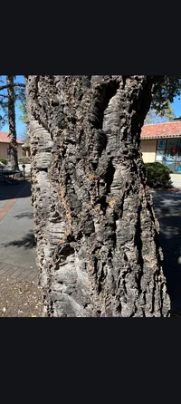

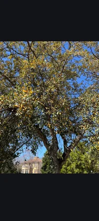

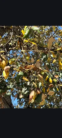

I am trying to diagnose what I believe to be a fungal infection on a group of Q.suber (cork oak). The black staining is all the way up and down the trunk/stems, and seems to correlate with the sides that get the least airflow. Trees with buildings immediately west of them have the symptoms on the west side, while those with buildings on their east show symptoms on the east side. All of the ones in the courtyard have solid green foliage, though sparse, but the ones by the road look worse in the foliage and less bad on the trunk. One in particular by the road is yellowing badly, and has black spots on the leaves; maybe sooty mold, but doesn't look right either.

The opening on the lower trunk photo looks like an old injury from excavating or landscaping equipment. Overall the site conditions (super compacted soils) would cause all the crown/leaf symptoms especially if the growing season was dry (or too wet). We know for sure that pathogenic fungi are generally opportunistic to multiple stresses on a given tree. This is no help to ID'ing a fungus but that's how I see this situation.

Q suber is a funny bird. They shed their leaves this time of year, or most of them. This can make them look very sickly, watching the ONE large tree I know of, this also seems to have cycles of heavier shedding years. Of course the cycles can be due to weather..
The sooty dark on the bark seems similar to a sooty mold, possibly due to honey due from aphids? Is this the high side of the trunk? Meaning the area that would get rained on from the bugs?
The wound looks like dieback from a damaged root, possibly colonized with wet wood.
@moss I am fairly certain that soil compaction from foot traffic, and of course climate issues are significant contributing factors. The area that looks like an old injury is assuredly not. All that light beige to brown area is soft, as if rotten, and that discoloration is present on the rest of the trees, going way up the trunks, and only in spots. That one was just particularly bad.
@evo I considered sooty mold, and despite the majority of it being on the high sides where honeydew could deposit, the black stuff doesn't come off easily. I am familiar with the leaf drop and how scary they can look at molting time, but only the ones by the street are looking yellow at the moment, and they show no signs of new growth to replace these dying leaves.

Do you think it could be ‘early leaf shed’ due to higher stress being by the road? Sometimes it’s hard to not forget about early shed / late leaf development in the oddballs.

After looking around at other trees, and perticularly plants under the affected trees, I do believe we are looking at black sooty mold growing on honedew. There are a number of environmental factors stressing these trees, and since paclo is contraindicated for severely stressed trees, I am going to say that these trees should get an a compost leachate to boost their health first. I will post progress pics when when it's warranted.
