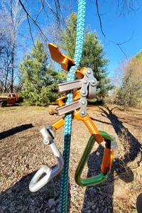

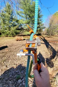

An old thread, but I recently got a unicender myself and thought I'd share my tending/rope keeper that I made. I've quoted you Stephen because this design seems to accept wraps either direction. I'll be giving it a climb tomorrow to test for sure, so far it has passed the test just hanging in the shop with no body weight on it. I have found that you can tend slack to the left and the right but tending straight ahead on the bearings works the best, very comparable to tending the roperunner. 20200106_192756.webp20200106_193446.webp20200106_193753.webp
