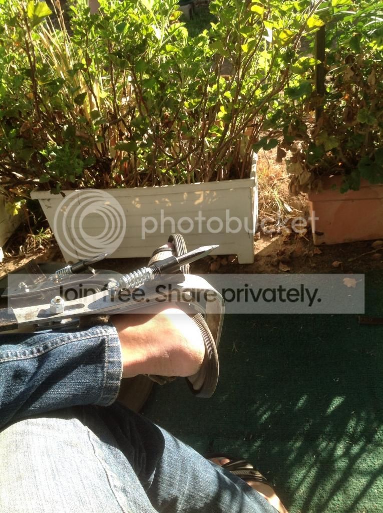

Triangular Configuration of Conventional Gaffs
If I was anywhere near as good a Moto-Crosser as arborist.....why I'd be rich and crippled....instead of poor and crippled!
The gaffs came out nicely, and I'm quite pleased with them for dealing with thick barked trees.
Now I need a pole gaff version of the same design!

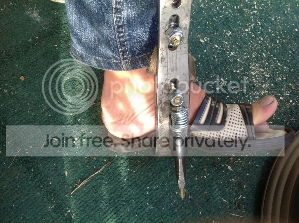

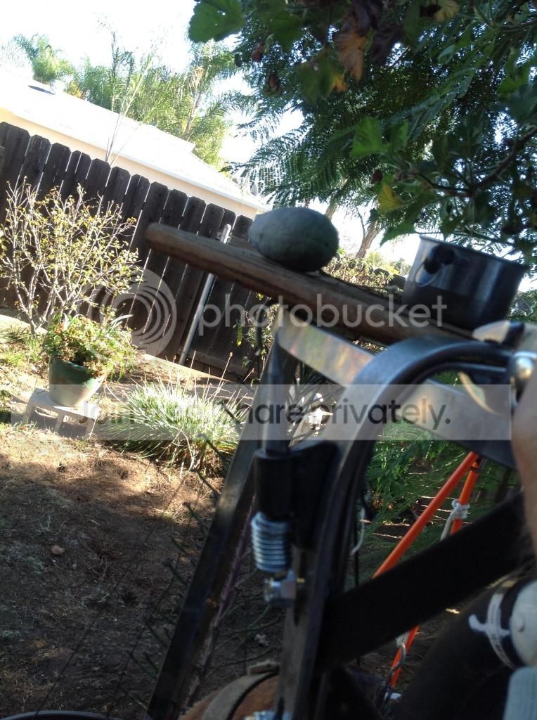

These are my round pole gaff version Innoculators.
Extended.
They're about 1 7/8 retracted, and a little over 2 1/4 extended!
May be a bit too pointy. Can't wait to test them and see.

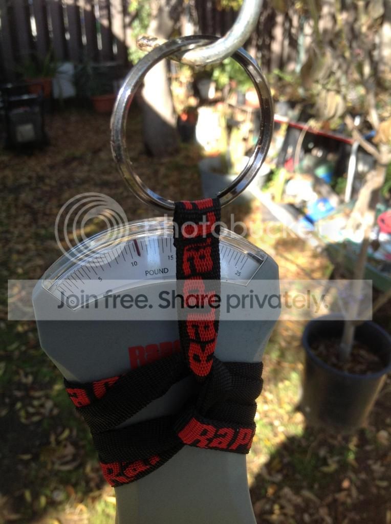

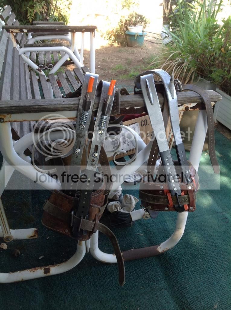

Weighing in at 6 lbs a pair with spur stays, we have a new set of Buckingham titanium pole gaffs on the right. How much does a set of Geckos weigh?
The modified Buck titanium and steel Innoculators are one pound heavier each weighing in at 8 lbs.
I get the feeling these Innoculators will allow you to tiptoe up the tree with big strides using less effort. Particularly in dead barkless trees.

The complete set with straps, stays and ready to rock?
Hang them off a fish scale or something, snap a pic, and post it please?
Thanks,
jomoco
I've got to admit that's pretty dang light, considering my Buck Titaniums weigh in at 6 lbs with bashlin steel insert spur stays.
The first mfr to make a 2in1 gaff with pole gaffs in one configuration that can be spun 180 degrees to get tree gaffs, will have a top seller on their hands. The upward pointing gaff would need a shield on the shank.
Lots of conifers and eucs have very thick bark on the lower trunk, thicker than pole gaffs, but up top they're normal, making pole gaffs preferable. Being able to quickly switch from tree gaffs to pole gaffs, then back to tree gaffs, holds great appeal in my opinion.
jomoco
They are lighter than a bag full of cheezy poofs, but the 240 weight limit has always sketched me out. Although I weigh 180 pounds soaking wet, and will never hump 60 lbs of gear with me into a tree directly, hearing about them breaking is not a comforting feeling though. I know we had a 280lb guy climbing on them, and never had an issue. Doesn't mean they couldn't fail though...
Quick switchover would be nice in different situations however. When in the market for new gaffs, I would lean toward the Bucks.

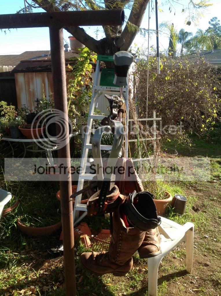

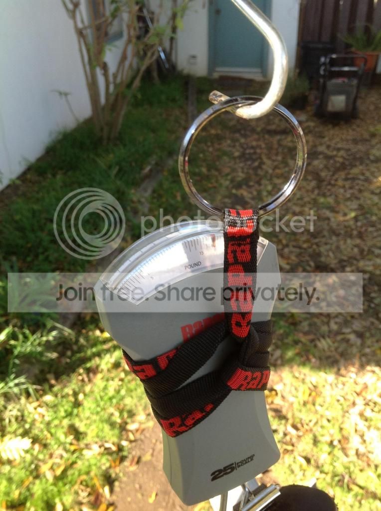

So just out of curiosity I weighed boots, braces and bucks to see how much heavier my climbing weight was?
A tad over 17 lbs!

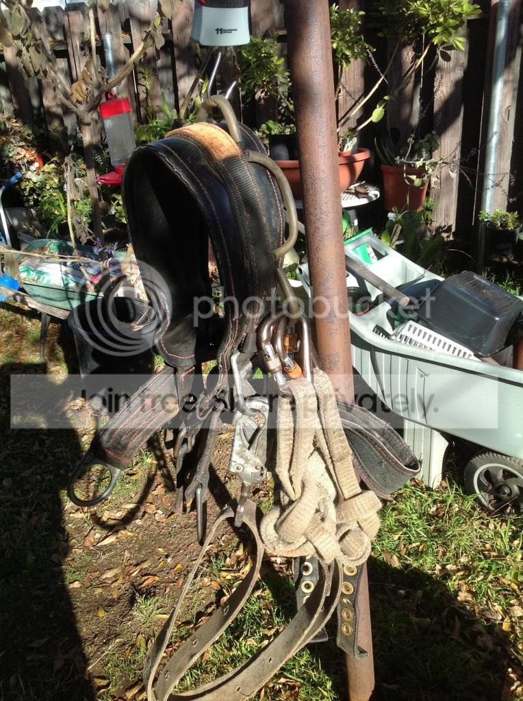

Old school saddle and lanyard with 3 biners and nylon loops?
jomoco
Holy mackerel!
12 lbs!
So say I weigh 30 lbs heavier than my 165 lb weight. Add 10 lbs more for an ms200t, puts me at 205 during removals.
Pretty heavy for a munchkin eh?
