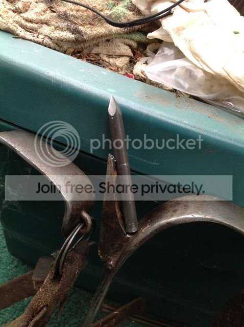

I was serious about the gouge not the bear. Picture the 1/2 round gouge with the right complex bevel. An Inuit ulu knife style would be intersting to try. Experts only!
I'm thinking that a threaded round rod could be lengthened as the gaffs get progressively shorter from sharpening?

A round rod sharpened like pencil wont work cause the top of the bevel will push against the tree before the sharp end sticks in adequatley, thus tearing out the spike before it is set properly.

I'm not sure you need new spikes. I've never used the geckos, or spent a ton of time on spikes like some of you guys but I thought I'd offer some advice before you buy a new set.
You mentioned that you keep your gaffs razor sharp. This could be part of the problem. If you gaffs are too sharp they will act like a chisel, initiating the tear you're talking about. I'm thinking you want them to part the wood fibers rather than sever them which would lead to a blow out like you've described. Also, do you have too steep an angle on the bottom surface of the gaff? This could direct the force on the point of the spike outward rather than downward, again, like a chisel.
Just some food for thought.

But I will be surprised if it works,for two reasons:
1. The closest edge of the spike to the tree (which is to be spiked) is the bevelled edge, so it will push away the sharp bit before spike has done its job.
2. On all brands of climbing spurs there is a great big build up of supporting steel on the spike(were it attaches to the shank).I'd say that there is a reason for this and suggest your measly little pencil spike might bend quite easily out of whack,unless you are re-enforcing the attachment point.

I THINK that the angle that you want to follow is the outside of the spike not the inside. The way you have the new spike positioned will have your foot quite a ways out from the tree. The force of the load is cantilevered not pushing down and into the trunk.

Now that you've got your test mules, could you not just toss out everything you know about sharpening gaffs, get out a double-cut barstid file, round the sides of those things over, then get out on a limb and literally see what gives?
You wouldn't get them to a perfectly circular point, but you could get an oval point with no sharp edges, which would let you see if your theory is at least on the right track.

You're right Northwind, and I'll eventually do and document just that.
My problem is each time I start a proof of theory project in my garage, it soon morphs into a better embodiment of the original idea. From better gaff setting ability at acute angles, to sure footedness at almost any angle.
It drives me crazy, gets far more complicated, have to go begging my older brother for mill and lathe time, springs gizmos, I'm drownin here guys!
